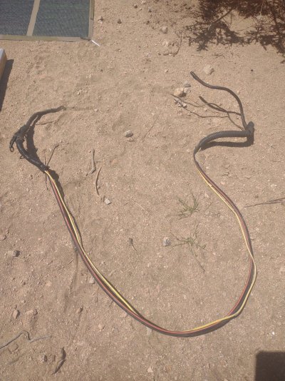

I've had some trouble w/ the alt not activating, so I decided to clean up some wiring.
First I tracked these two wires from their cut and taped ends back to the solenoid that's mounted behind the driver's side headlight. They tested hot w/ the key on and went to nothing.
Would they have gone to a previous alternator configuration?

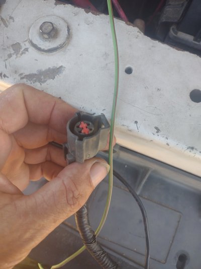

And this green w/ a red stripe wire seems to come from the rear of the alternator (unable to see w/o opening things up on the inside of the rig and this is not the best time for that) and it has this plug end. It was wired all the way to the driver's side and tucked behind the batt.
Is it from the alt and for what?
There is another cluster of unconnected wires behind the alt on the motor that I can't get a pic of yet.
Any idea?

Your problem is you need some diagrams from the bus body manufacturer. You will have a lot of non-Ford wiring and components that were added. Ford only gave them the cab and chassis.
Lightgreen/red is the keyswitch 12v that triggers the alternator to come online and get ready to charge. When this wire loses power it tells the alternator regulator to take the alternator offline so it will not run down the battery when the engine is not running. So this wire will go to your alternator and if you did have another alternator installed, then it would need this wire also.

I did some digging and found a corresponding socket tucked into the fat amount of wiring in that corner. The socket has three wires going to it but a lt green w/ red wire was one of them and it was in matching locations in the plug. I plugged it together and now I get the dashlight that indicates it's discharging.
