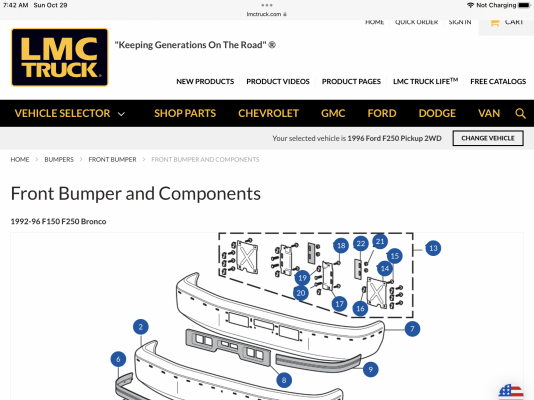

Hey guys I need more airflow to my radiator. I want one of those factory turbo/PSD bumpers with the cutouts. Do they sell those plastic inserts? I swear they do but I've spent an hour looking online and can't find them. I'ma get medieval on my boring stock air-flow-blocking bumper with a grinder and a cut-off wheel.
12,464
11,228
I believe that LMC Truck sells it. They do if I looked at what you're talking about. If LMC sells it, the Bronco Graveyard probably sells it too.
What the heck, I just looked there before I posted. You're right, I looked in the Bronco section and not the Truck section, lol. Thank you!

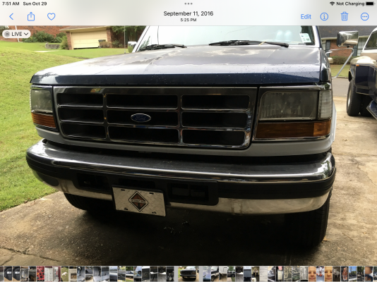

I was able to take my stock 93 bumper and cut it to fit the plastic insert. At the time I got mine from Rock auto (they don’t carry it any more). This is the 93 bumper with insert added. It did make a difference in cooling, a lot more air over the bottom of radiator.
Nice that's what I'm thinking! How did you get it to snap into the bumper?
I got my insert and marked the large rectangles and cut them out. I then touched the rectangle holes up to fit snugly. After rectangles were where I wanted I put lipstick on the tabs that slide through the slots. I pushed it against the bumper and then marked with a sharpie pen. I drilled each end of the slot and then took an abrasive wheel (dremel) and cut slots between drilled holes. The insert snapped in just like the factory ones. My bumper had the black rub strip acrossed it and I cut that (oscillating tool) to match the insert. I wish I had a better picture.
Nice work! Thank you for the explanation, if I go that route I'll be sure to follow suit. Though just cutting a big honking rectangle is sounding better and better... :Thumbs Up
