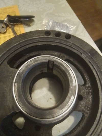

I was just taking a closer look,I believe it has a old sleeve on it,

The sleeves are usually chromed and pretty tough. If there is no groove where the seal runs, you should be good. If you are trying to seal a pesky leak in that area, make sure to put a little sealer on the keyway of the damper. Oil can migrate up past the key and then around the washer and bolt and make a leak that is hard to find.

When that happens I just make note as to press it in farther than it previously was as to not hit the groove
