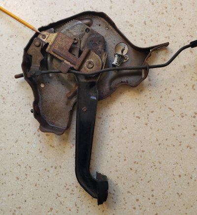

Removed my e brake assembly and the pencil points to the area that needs a squirt of WD40 etc and it will start ratcheting again.

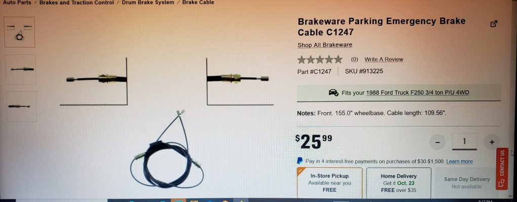

Now I need the front brake cable for my 155" wheel base 1988 F250.
Getting the OE cable out front the floor was a ****.
