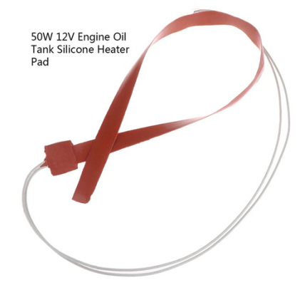

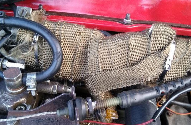

First off the injector lines. The theory:
1. the injection lines hold cold fuel that will get squirted in the engine first, until its all replaced by warm fuel from the fuel pump
2. the metal will be cold and cool down any new hot fuel until its all warmed up
Wrapped the heating pads around the injector line, secured them with kapton tape and finally a layer of heat-proof fibreglass. Seems to get toasty in 20-30seconds and help a bit with coldstart.
