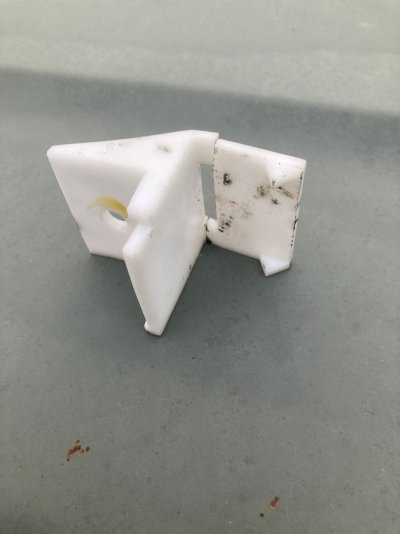

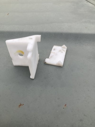

That white part in the image is a clip that holds the Transmission computer in place behind the left cover where the hood opener also is installed on a 1989 F-350 7,3 diesel.
as you see, mine is broken, I like to get a new one?

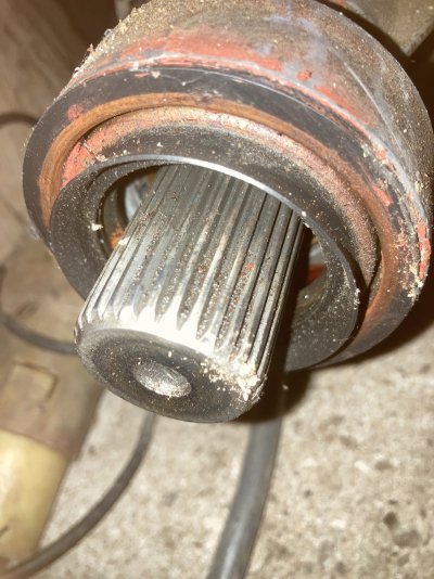

Part three; the seal on the BW 1356 transfer case where you insert the rear drive shaft?

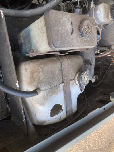

Oh, I forget, is there a new coolant overflow tank somewhere to buy which is not horrible expensive ?

I don`t recognize that plastic piece. You can do a repair with Super Glue and baking Soda.

The Coolant Bottle I think is no longer available. (NLA)
The junk yards is best bet for an original one.
Don`t know what you have in France for JY`s, and doubt won`t fine many old Fords in there.
The one`s I come across here in the States, are not always in the best of shape.
Maybe to get you by, a Super Glue patch will hold you for a while.

It's the combination of windscreen wiper fluid, and the cooling liquid catch can (which is broken) for the 1989 model year.
I'm not sure to repair, both reservoirs are pretty chrispy.
they're old and brittle.
If I can't find any of this model for a reasonable price, I might have to find alternative models.
with all the big expenses for shipping, and availability of parts, we start more and more to look like Cuba (and their way of repairing those '50's cars)

Perhaps you might consider cleaning, roughing it up, cleaning (x2), and putting some fiberglass matt/cloth with resin over the exterior. Unless you are going for a restore, that might be a field-expedient fix that ends up also being a long-term fix.

I like the sound of that!, and maybe somewhere in the future when I stumble over a brand new original...... (dreaming...)

I’m pretty sure I’ve seen some reasonably priced ones on eBay or Amazon, can’t remember which. Just replaced my Radiator, water pump and thermostat and was contemplating replacing the tank also but didn’t. $ is getting tight.

anyone a suggestion for that white clip(broken) that holds the trans computer in place? (in LH footwell behind the kick panel)
