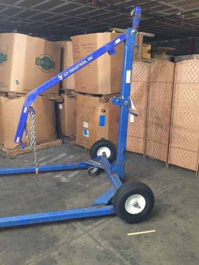

I bought a BlueBird one like this years ago to work on trucks for $150. It goes higher than standard pickers do. I have not had to pull my 7.3 engine knock on wood, so not 100% sure it would clear the core support.
In general I find it easier to pull the hood, use a leveler, and a forklift, but not everyone has one of those laying around. The forklift can go very high, it does not have legs going under the car to catch on things, and its rated usally at a minimum of 2500lbs. I have pulled several engines that way (Some with the tranny, some without.), but I have yet to pull a 7.3 or 6.9.
Bluebird makes these ones with the longer legs and longer bent arm, but most shops and rental yards by the smaller ones for cars. (Harder to find these, yet to see another local one for sale.) These also can take the heavier weights as they are a solid welded frame, not foldable like a HF. But it is much easy and user friendly to store a foldable cherry picker. (Mine sits behind my trailer at the storage yard.)
