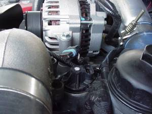

The little metallic circle you see is the top of the EGR. Simply unplug the harness (blue band). I never did plug mine back in for service, but it was always plugged back in without comment. I would unplug in the service lane when I picked it back up.

Did you notice performance gain/loss with it upluged.. or get any codes.... Or is it mostly for leaner oil...

Only cooler EGT's and cleaner oil.
It will leave a few EGR codes, but the dealer never cared.
Also, when you remove the speed limiter and run ~100mph it will leave an over-speed code.
FYI- The speedo shuts off and goes back to 0 when the truck hits 100-105. I nearly shat the first time it happened in my 02 because I thought something broke.
