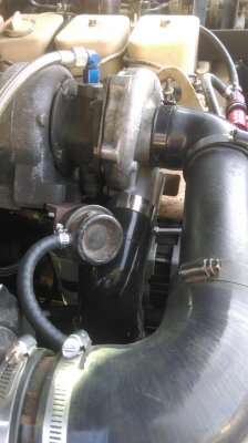

I got the intercooler plumbed in over the weekend. Its nice to get that cross pipe off the top of the engine. Seems to be working really well too.

yeah, I snapped a couple. Not all that interesting, but the pipes went in pretty clean, and now I can move the oil fill from the goofy #3 spot up to #1 where it belongs.
