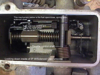

The pic shows the fuel cutoff mechanism.
