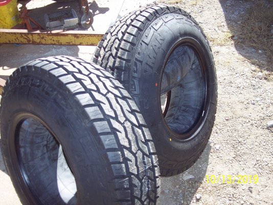

Very well said, Bart. I agree with all that you said. I did forget to mention the ratchet strap trick. I've done it, mostly on ATV tires. I try to release the strap as soon as it starts pushing the beads out so that I don't have to stop putting air in the tire to do it. If both beads happen to seat, I stop putting air in the tire and loosen the strap at that point. I did forget to include a picture of the tube trick in action. I've posted it before, but it really does need to be in this thread as well. Here's an example of the tube trick.
