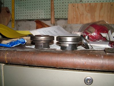

I hate to say bad things about a good company, but I also hate for people to buy bad products unknowingly. Attached is a picture of the Throwout Bearing I got from South Bend. It came with the stock clutch they sent me. When I pulled the transmission after 1000 miles I saw the problem. If I put the TOB Bearing into the fingers of the PP (Pressure plate) there was just a whisker of play. So, when the TOB is pushed into the PP, the hole in the fingers is even smaller, pinching the lip that sticks out ahead of the TOB. Or, the slightest vibration in the shaft,
see http://www.oilburners.net/forums/showthread.php?t=34690
would cause the lip to be pinched off.
South Bend sent me an entirely new clutch kit at their cost and after 4000 miles I had to pull the trans again. The TOB looked just the same. For more information, see the link above.
In the picture the TOB on the left has at least 105,000 miles on it, the one on the right has 1000. Look closely on the right of the right TOB and you will see a think rubber ring and a think metal ring. Those were spinning on my trans input shaft both times when I pulled it out. South Bend called Luk in on a conference call that very day that Luk said everything was performing as expected! Why put this lip on the TOB if it is going to be pinched off?

PS Sorry for the double post. Didn't realize I couldn't come back and add the link. I hope the picture attaches this time.
