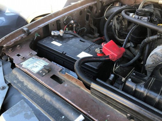

I know I am bringing this back from the dead, but I feel this should be put in the Tech Articles section. I will share my experience with this mod as well.
I did pretty much everything the same as riotwarrior. I took some flat stock and drilled oversized holes and welded it to the original fender mount tabs. I drilled holes in the brackets 1" above the original holes in the other brackets. I wire wheeled and sprayed some cold galv on the trays. Installation was very straight forward on the passenger side. I only got one bolt to go back into the rad support, but I was fine with that considering it was braced back to the fender. The driver's side was a little more challenging. I thought I was fighting the inner fender, so I cut some on it with the die grinder. In the end, I did some bending on the brackets under the coolant overflow and windshield washer bottle to get the holes to line up. I also added some 1" angle to the ends of the battery trays after grinding down the stamped factory lip. The battery is pretty tight on the drivers side due to the wiring harness being behind it on the fender side.
I also ended up installing some longer and larger ground cables from a truck I junked. The starter spins fast now and I am pretty happy with the setup. I bought batteries with stud connections on them but installed some post adapters on them from Amazon. With some additional tapping, I got them to fully thread onto the stud posts.
Also, I managed to get some Group 31's on sale at the local Rush Truck dealership for $60/ea! Too bad they wouldn't take the 65's for core! I was still money ahead even paying the core charge considering everyone else wanted about $100 or more for each battery.
Good luck trying this on your OBS truck!
