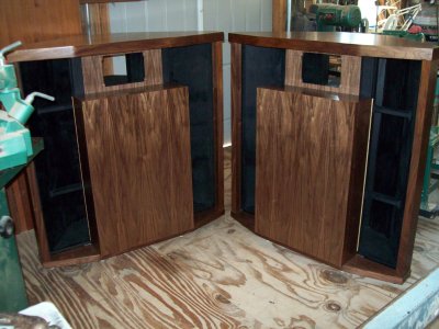

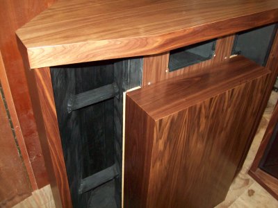

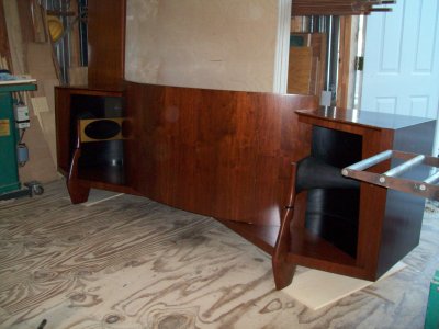

I'm old school.
My first question will be: What kind of music you like to listen to?
And then: How do you like to enjoy the kind of music you like?
If the answer to the first question is rap, then I don't have anything to say to you. Those that listen to rap don't have a brain to appreciate what music is really about.
If your answer to first question is jazz or classic (even classic rock) then I can help you. I design and build hi-fi speaker enclosures as my second job (that gives me much more money than farming)
Your answer to second question will help in putting your system together. It's not the same to enjoy your music with quality, definition and depth than to annoy everybody with loud thumps from a block away.
Here you have a couple of pics of systems I built a couple of months ago. The same principles can be adapted to work in the smaller space of your vehicle.
