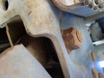

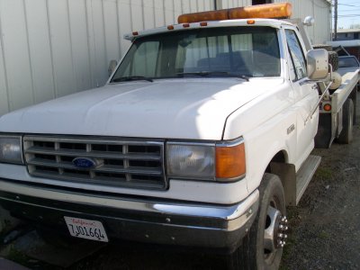

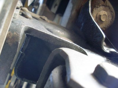

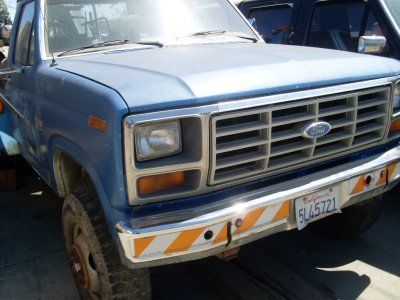

Prove it? no problem. At the moment, all I have are pics of the two examples, a little later, I will have data on the frames between the two. f450 frames and crossmembers are visually and measurably thicker than f250/350. the springs by your own admission is different. the bolts that hold in the f450 springs are also larger in size, so if you do put in the f450 springs, you will have to either drill out the shackles and brackets for the larger bolts or live with a ticking time bomb of sloppy spring eye and bolt combo.
you may have the t-shirt, I have to pass DOT inspections.
here's the pics now. data to back up my assertion in a little while.
