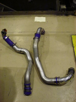

Here are some of the IC install pics. I thought we had more but things were kinda rushed. cookoo Questions welcome;Sweet
The part I used for the intake hat is a propane mixer air filter adapter, we cut the center out after turning it shorter to clear the turbo and thru bolted a 04 PS inlet elbow on it. IC is 04PS as is the hotside tube cut and welded to point at the turbo outlet. Tube on left is hotside, tube on right is an 01 ps hotside used on coldside that fit right in with the 3 inch elbows from ebay. I will dig up more pics when the son gets time, school and a job ,what more could a parent ask for:hail

Good god almighty, that is one mammoth intercooler. Aren't the IC's that most IDI folks a hair smaller than that? What kind of boost and EGT's are you making? You do look very happy in that last pic...

if you buy the ATS or Hypermax kit, you will get a half height IC. There is a minor concern of increased temps with a full height IC. I know with my ATS IC, I popped my safeties on my AC compressor. Two things I think contributed to that though. One...the IC is blocking half of the condensor, so the recovery time is not as good. Two...the previous owner retro'd R134 into the truck. R134 runs at higher pressures than R12, so that my be the primary cause of the safties popping since they are still set for R12 pressures. BTW, the cooler stack on a powderchoke is AC condensor front, IC middle, radiator in the back. I have a all aluminum IC off a powderchoke for a future project, but the AC condensor issue will need attention along with that install.

Skimball, the boost is at 9 max, egt highest ive had is 1000 very hadr short pull, wrong gear and all that,still getting used to the diesel from 460 swap.
Towcat, it does run warm on hot days, I have a upgraded ac condenser for 134a, we were on vacation in 100 degree weather and the safety never popped,engine temp was 22o most of the time, big camper and towong the wrangler, aftermarket 3 row rads do not cool a turbo motor. I have a oem 4 row and it does much better.

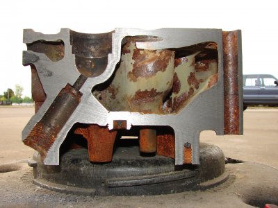

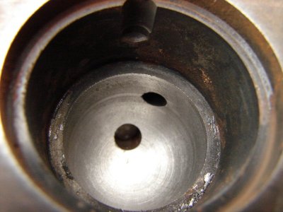

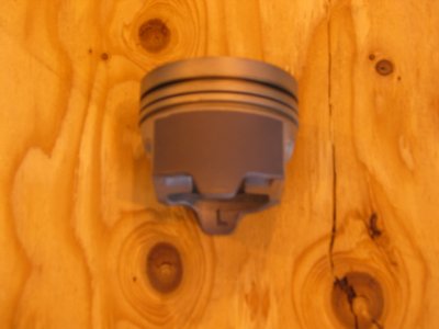

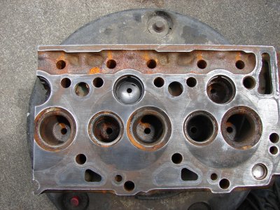

icanfixall, just for you here are some build pics:hail I have some pics of the heads somewhere not just the test head.Also one of the pistons after I coated them, had to redo the top of this one.

Now those are some great pictures of a cut down head. Anychance you can cut down thru an intake or exhaust port? Please.... What did you coat the piston shirts with? and why.... Sure looks like things are going 200 mph...:D

Yeah I will slice up the head soon, I want to see how thick things are. I coated the skirts with antifriction graphite, tops with ceramic. baked on. I would not do used pistons again the tops were a ****** to clean good enough. Maybe turn 10 thou off to lower comp then coat:D .
I coated the bearings and rockers with the graphite also. Manifolds and turbo hotside and downpipe with some heat coating also..
Ordered the supplies from the coating place mentioned at the other site.
