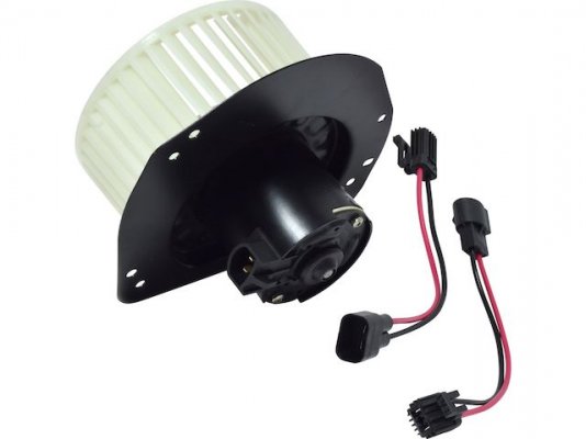

Blower motor is the large cylinder on passenger side of bay?
gnathv
Oct 18, 2007
1,051
528
Athens, Al
This is what you’re removing.

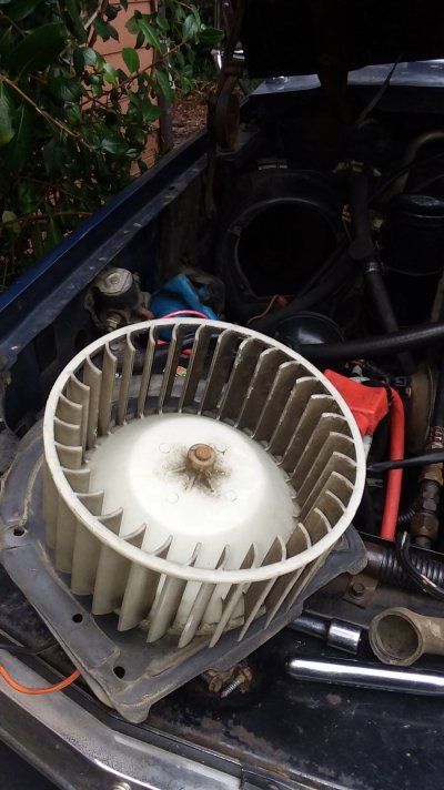

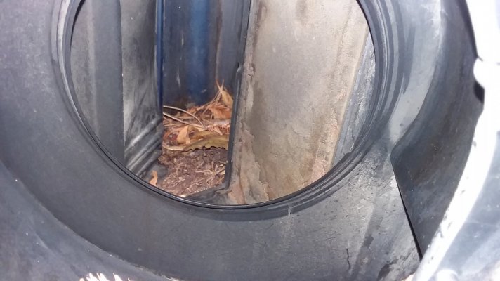

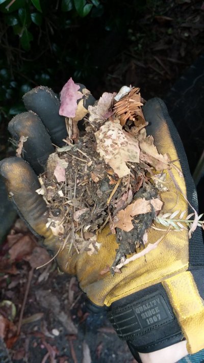

There was a LOT
The chute that goes down to the bottom was packed full.
