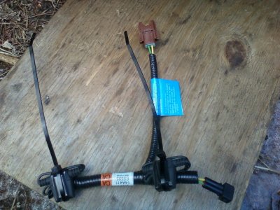

So it is just an in line fuse? Anyone have have a pic so I can see which wire is it?
I just can't bring My self to let someone sit on My drivers seat, let alone drive the truck. I have two trucks I'll have to do this so I'll appreciate some instructions to identify the wire.
Thank You.
Ok I see it now (page 5), can I buy this part (part #?) so I install it? I don't think they'll just give it to Me even if I drive the truck to the dealership.
Mel, could Your contact at ford sell Me a couple of this plugs :angel:.

Well thanks to member Silver91Hatch I was able to get a part # and good tips for this recall. I bought one from My local ford dealer and plugged it in about 5 minutes, the only hard part was to get under the truck since mine does Not have this plug on the master cylinder but on the frame. Here are a few pics for someone looking for a little help.
