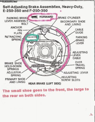

The adjusting lever prevents the adjusting screw from turning, if it's not there or touching the adjusting star wheel slots.
The auto adjust takes place when traveling in reverse, a hard braking must take place to turn the adjusting screw wheel.
On a non self adjusting brakes, the star wheel is prevented from turning by a spring across it.
