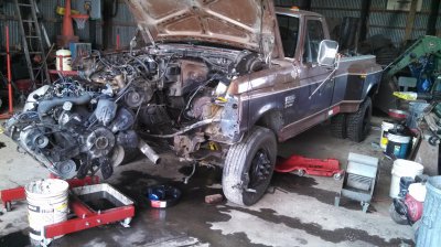

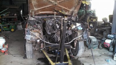

Went with removing the core support method. I can't figure put how I'd pull the clip in one piece alone! Took me some time (especially since it's my first time working on one of these trucks) but it's out.
Thanks!

Don't forget a buddy to grab the other side! It would certainly be hard to do by yourself.

Nice job. Looking at your fan clutch seems like the seal has failed. Kinda looks fuffy around the fins. Might want to look closely at that. If its wet and leaking theres no good reason to put it back on. Actually now is a gear time to replace it. No easier time either. Why was the engine removed.

I'm gonna have to ask you to explain and expand what you mean by a fluffy fan clutch?
Suspected cavitation, probably isn't going back in.

That's what makes it so good, leave rad attached less work than a rad support IMHO but takes two people to lift it out.
Bottom line he got it out alone!
