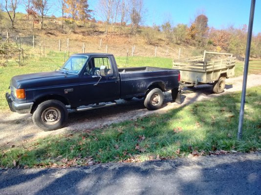

I've been daily driving the truck for a week now and it has proven itself good :Thumbs Up .
I only put 260 miles on it in the week, but around here that's a lot,lol.I am very happy with the zf5 and the truck overall. I am hoping to get the gooseneck hitch and flatbed on soon, bed have to figure out what I'm doing for paint at some point while the bed is off.
