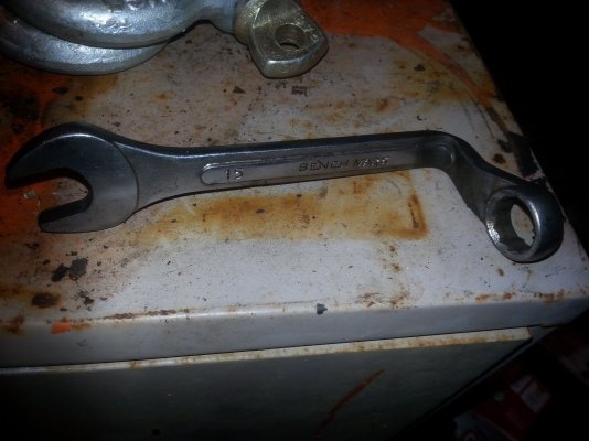

For those that run the Powermaster 9051 in their PSD's, you know the challenge of trying to access the top mounting bolt with a socket/extention/wrench/universal etc.
I find that a wrench bent like this one, works really nice when reaching in from the wheel well, to access that top bolt. I wouldn't even consider trying another method anymore with Powermaster starters.
Just thought id share
