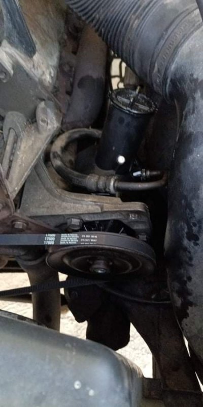

Alright! Got the power steering pump swapped out. Vato zone had the pulley puller and accidently gave me a fat discount on the rental tool that was brand new in the box. So now I have a pulley puller.
Pump works excellent. I drove it home from Denver up I70 and she did 50-55 no problem.
Thank you a million times for the help. Love our community.

Glad to hear. And wow, so much room in front of that pulley.
This is the clearance between the PS pulley and the fan shroud on my E350:
