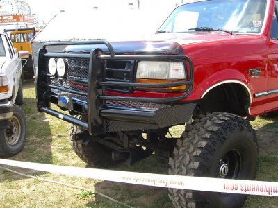

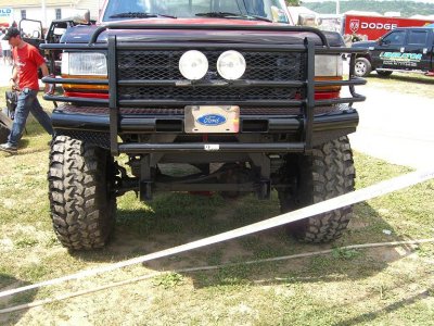

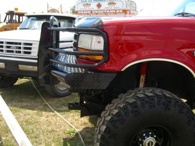

not real simple but a bumper i thought was real cool
