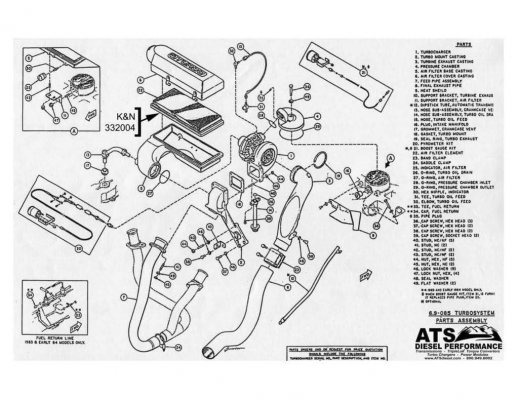

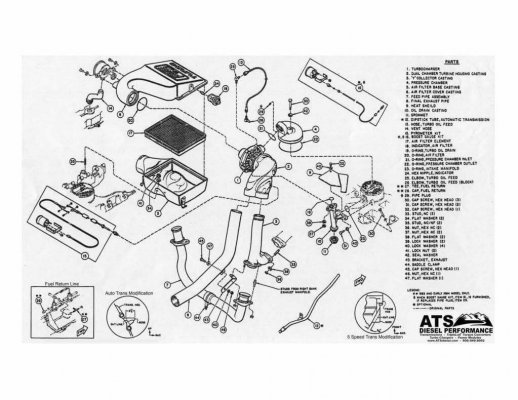

Just to confirm, that's the ATS 088 turbocharger. Although for what it's worth, I have the 088 setup with the older 085 rectangular airbox. It seems they are interchangeable. The best way to distinguish between the 085 and 088 by looking at the turbine side of the turbo. The older 085 is just a regular off the shelf casting, while the later 088 was custom cast for ATS.
