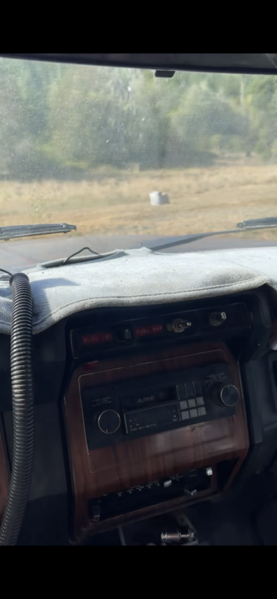

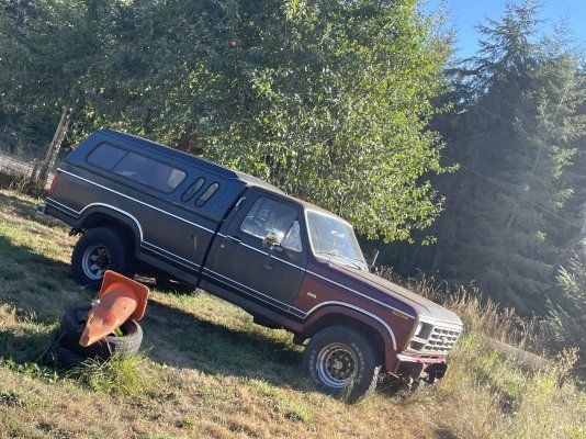

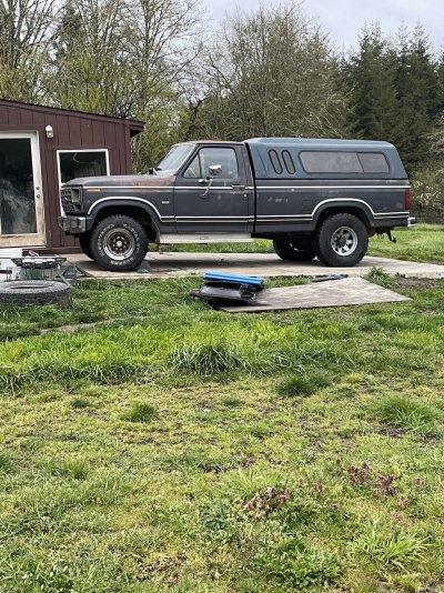

Hello everyone!! I am new to this forum as well as the 6.9 IDI. I need y’all’s help figuring everything out about this truck. As well as first things to look into, maintenance I should do specifically for this truck etc. I want to hear it all. Been reading all I can but I’m at the point I need people to talk to. It’s a 1983 F250 with the 6.9 IDI, 117k miles, ats turbo kit but not exactly sure which one. I can’t seem to find a catch can but also could be overlooking it. Also it has a switch for a fuel pump, and when you turn it on you can hear the automatic fuel pump turning on, but you can drive it just fine without it on. It has the original, manual fuel pump but any idea what that is for? Also there’s another switch for the glow plugs, can that be rewired to anything better than the glow plugs being controlled by a manual switch? What else should I be looking for? No rust, couple surface rust spots but nothing that has started working though yet. I’ll post some pics and a short video of the engine
I have a manual switch on my Blue Truck and I love it. I wouldn't have a 6.9 style glow plug system that doesn't use a manual control for the glow plugs. Even though it's debatable, I plan to hook up a manual glow plug control on my 1987 with the 7.3 style system too.

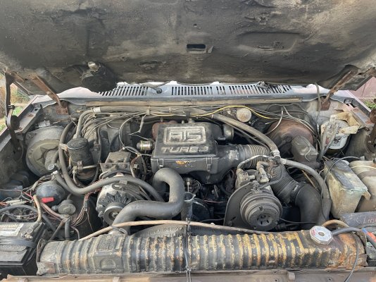

Thank y’all so much! Gettin a lot off of here. So the extra fuel pump shouldn’t ever be used is what I’m taking, should I just eliminate it in the long run of things? Here’s a pic of the engine bay completely with the ats kit

Also what would be the best set up with what you see in the pic for cross country driving? Fuel efficiency as well as towing a horse trailer. I’m 22 and I’ve been to every state west of Texas and started in WA. Having two horses I figured this truck would be the way to go. So here she is
You already have a turbo and that's the first step. I can't see any vacuum lines going to your injector pump so I assume that you have a four speed transmission instead of a C6 automatic. As far as I'm concerned, that's the next step. What I would do next is to install a pyrometer if you don't already have one. If you have one and it doesn't work, get it working or buy another one. Driving empty, it's not not as big of a deal (unless you have a heavy right foot), but for towing, even just two horses, it's important to keep an eye on your EGTs. EGT stands for exhaust gas temperature in case you didn't already know that. Another good thing to remember is that the gauges on our dashes are nothing more than updated idiot lights. They are only there to make the driver feel good and may not be very accurate. A good set of aftermarket gauges is a very good idea. I also recommend a vacuum gauge to keep an eye on your vacuum pump. If that goes, there goes your power brakes. If you have a vacuum gauge, you can see if your vacuum pump is starting to act differently. After those things, the upgrades start to get more expensive and are nice, but not a "have to have item". An intercooler is REALLY nice, but not needed as long as you're not towing heavier than a couple of horses. A ZF5 swap would get you better mileage on the highway. I purposely only mentioned things for your current set up, not bigger turbos and injector pumps. Those are a completely separate subject.
