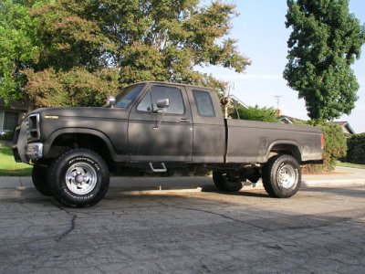

I am new to the board... A while back I got an 84 F250 4x4 CC. It will not be a daily driver... I will use it to haul materials when I cannot take them with my car as well as desert trips. The first big trip I took it on I had a bunch of problems... overheated it and ended up having the radiatior, water pump, and thermostat changed on the road. I should have seen that one coming as it was showing signs of cooling problems prior.
Now I have what I guess is exhaust leaking into the coolant... the coolant overflow tank is constantly bubbling when the truck is running... but there is no oil in the coolant or coolant in the oil. I am guessing that this means at least a new head gasket and I should prolly replace the studs while I am in there. I understand that this job is easier with the engine pulled... any other work I should do while I will be pulling this?
Any advice in general? This will be my first engine pull from a car and my first time doing really major work on a diesel. I have done extensive work on motorcycle engines and the like... but this will be bigger than what I am used to. Thanks
