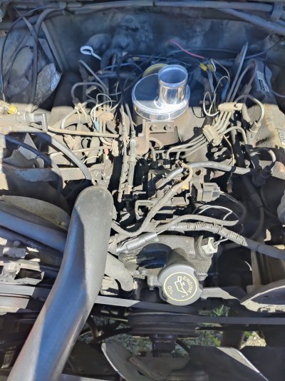

Classic diesel design makes a intake hat and air cleaner system for the turbo and naturally aspirated ones. Here's the intake hat on my naturally aspirated 7.3 I bought to replace the stock one
That looks well made. I assume you have an intake hose running to a cold air intake somewhere? What diameter is the opening on the hat?
