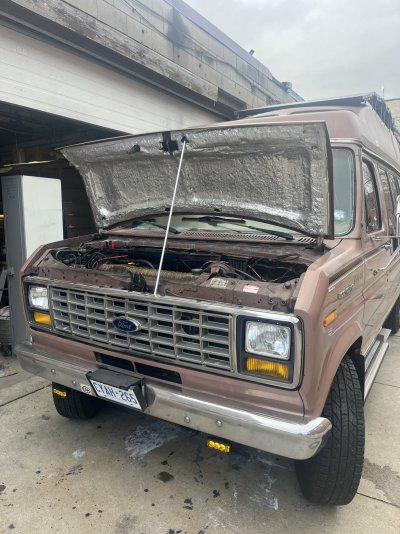

Depends on your headlights sizes.
For my ‘86 with the 5x7. I went down this rabbit hole and ended up with Hella H4 Eurostyle housings, and there 100w/50w bulbs. Plus the relay harness.
Really wanted some 5x7 LED’s but since I drive mainly in the winter I was concerned about the LED’s not melting snow, and the ones with heaters like (Trucklites) are $400 CAD each!
Then I added some nice bright yellow fog lights under my bumper to help on darker roads and storms.
