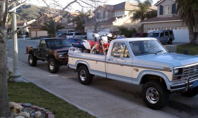

Update time...
Got a couple hundred miles on it and so far so good. No complaints aside from 2nd gear being a little crunchy if you try to shift it fast. Tows great compared to the old C6. Drug this mess up to the high desert over the weekend and pulled the pass an extra 15mph faster than normal.
Time to work on the fuel system now. Got to replace the 250k mi original injectors

This is still NA and the change is the stick only? I assume you ran the 4.10s with the C6 for a little while correct? What gear did you climb the pass in and what was your speed? The clutch working OK now?
The truck looks real nice. Will the injector replacement include an upgrade in fuel flow to accomodate more power/turbo, or will you include that when/if you rebuild the engine?

Yeah still NA. At the top of the grade I was up near the governor in 3rd whereas with the C6 i'd be in 2nd with rpms falling. Couldnt quite pull 4th without ******* the pyro, so i'd just run it at around 3k in 3rd with the EGT's at around 800. I'd say i dropped to 45 at the steepest part right before the top. Clutch works good.
I just planned on getting some matched BB code injectors. No need for anything crazy on this old motor.
