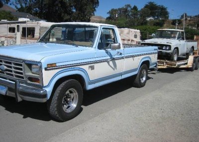

Figured I would try to document my ZF swap so others can have some reference if they decide to tackle this as well. I’ve been reading here for a while, but haven’t posted much. Great info and I’ll try to give back a little in this thread.
Little back story: Bought my truck about 5 years ago. It had sit in a field for 9 years not running. Owner said he would sell it for $250 if I could get it running. Sure enough, after a couple weekends of work and a few fuel lines replaced I got it going. I’ve put around 100k miles on it since with the only problems being one injection pump, one starter, and a lift pump. Has over 250k on it by now. Truck has got me through college and has never done me wrong. Now that I have a somewhat decent job, it is time to give it some love. Here I the only pic I have of the truck back when it was still on the 2wd front end.
EDIT: More recent pics on page 3 of the D60 conversion and ZF install
