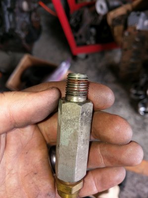

I went ahead and had a stainless line made to replace the factory line since i had new olives leaking, i'm just done messing with their horrible deisgn. I had them make is 1/4" NPT on both ends and attached it to the tee i had, relocated my 1/8" pressure sender for aftermarket gauge to the other side of turbo block. When i removed the lower 1/4" npt line fitting i realized there is an extension adapter to go from 1/8" NPT at the block to 1/4" for the fitting. So changing this to 1/4" fittings was really pointless for it intended purpose. My guess is this small fitting ensure that everything below is kept at a higher oil pressure. I saw no change in pressure changing this line out but it looks better and won't ever leak.

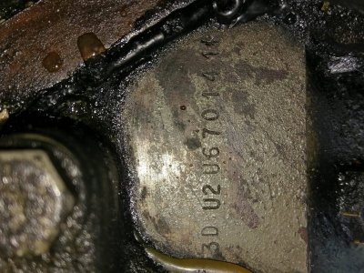

So I stopped in at the machine shop today and noticed the turbo feed line and port at the back of the block on the 1994 turbo idi I'm having overhauled is actually 1/4" npt directly in the block not 1/8" like my factory turbo 1993. Unless someone has replaced the engine before.

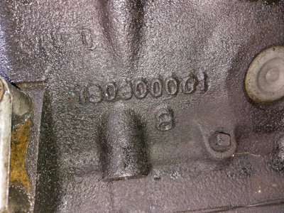

I wanted to update this since i got around to pulling my 1993 IDIT motor from my totaled truck. It had a bone stock factory turbo kit on it when i got the truck, when i replaced the turbo it appeared it had never been off to me, when i replaced the up pipes the bolts were defintiely stuck in the manifolds and i had to drill 2 out that broke despite days of soaking them so i assumed all this was a factory kit. Well i pulled the engine today and see the block has a casting number endin in C1 instead of C3 which would explain why there was a 1/8" NPT port on the back of the block instead of a 1/4" NPT

It had the factory smashed down pipe with all heat shields in place and all heat shields in place on the turbo, not bent every single clip and all heat shields on the factory up pipes. I wonder if they ever used 7.3l blocks in the early turbo trucks. I'm half tempted to pull a piston out and see if it has two keystone rings.

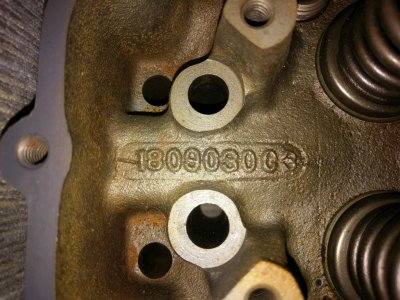

Here is a picture of the casting number on my turbo block heads.

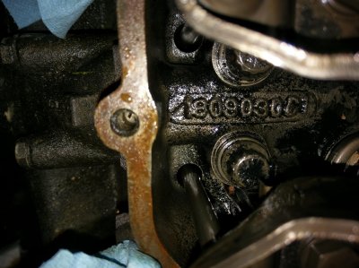

It looks like yours ends in a C3 just like the block number, this engine ends in C1, just like the NA block number. I also have a set of 7.3L non turbo heads and their number in C3. Weird.

A turbo block serial number starts at 1,116,331 and goes up from there. You have the 109,992nd turbo block made. Just looking at the oil ports and seeing they are 1/4 inch plug instead of the na 6.9 or 7.3 blocks having the 1/8th inch plugs in all the oil gally ports.. Nice find..;Sweet.
Looking up some serial number info seems to show some things about you factory turbo engine.
I also found this info.
Block c/n 10809000C1 was used for the entire 7.3L IDI years of production. The serial numbers for naturally aspirated applications are 500,079 through 1,116,330.
So your block, numbered 6***** would actually be early in the production run near the end of 1987 and early 1988.
Someone swapped engines....
