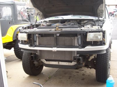

Hey guys, do I have to support the IC by more than those two tabs at the top or is that all I need??
Slade
Jan 23, 2009
199
Roseville CA
I'm running the 7.3 intercooler in front of my air and have no problems

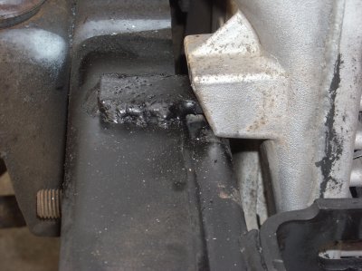

Wow, nice job. Can I mount it higher or did you mount it that way for a structural reason?
Slade
Jan 23, 2009
199
Roseville CA
I welded tabs to the frame so I could use the stock lower mounts.

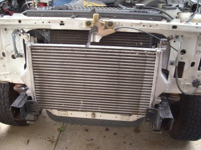

Thanks, I think I'm gonna do the same as you Slade.
Ok, now the intercooler is in, at least sitting there ready to be mounted. Ok, crappy cuts, I know. Thats what I get for using a sawsall.:D My 1 inch tranny cooler is behind it, had to fab up a bracket for that, I'll get pics of that later. I'm gonna weld some bracket up to hang it on.....stay tuned!
Questions, comments, tips, Thanks!

Looks good just make sure the holes througth the core support don't rub on the pipes.
Slade
385
What do you think the effect of that will be. Do you think the core support will cut through the pipe? This seems likely to me. But at the rate the Lady Moose puts the miles on, I may have quite a few years to remedy it.
Slade
Jan 23, 2009
199
Roseville CA
Just easier to make sure you have enough clearance now rather that have to fix it later.
typ4
Dec 24, 2005
9,131
1,431
Newberg,OR
What he said^^^^, I cut one in 500 miles, just sayin, way easier now.
