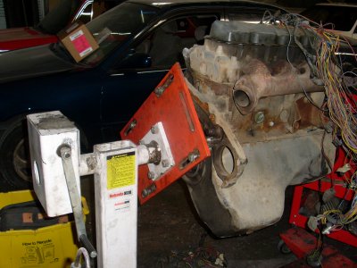

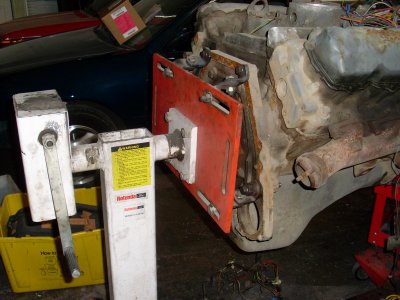

this is what I use to work on the teardown and buildup tho....
street value is roughly $3900. got it at auction for $40:D;Sweet
I call it the "rotisserie"

Guys.... I have seen Towcats spit and I'll tell you its something to behold. That gear box on the end allows you to rotate the engine by just cranking the tiny handle. It is important when installing an engine in any stand that you plan ahead what you will be doing. Once you start hanging parts on a block it gets heavy and out of balance centers. Then you can't turn the block to do any work where its facing you. What I do is center the bare block a little high towards the top side. Then I install the crank. Then the pistons and rods. Then the oil pump and pan. Then its interesting how close you get it to balanced center. Slowly roll the block till one head to block surface is level to you. Prep the surfaces, install the gasket, head and bolts or studs. Now rotate the block and do the other side being careful of all the weight from the out of balance side with the head on it. Then install the remaining head. Stick in the cam, lifters, pushrods, rockers on both sides. Torque down. Install the anti rotation dog bones and retainer in the valley and your done or really near to it....:sly
