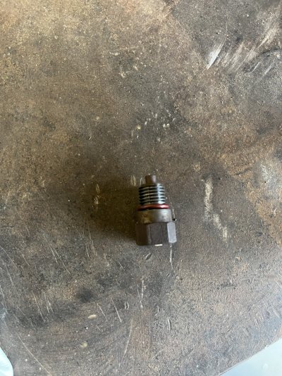

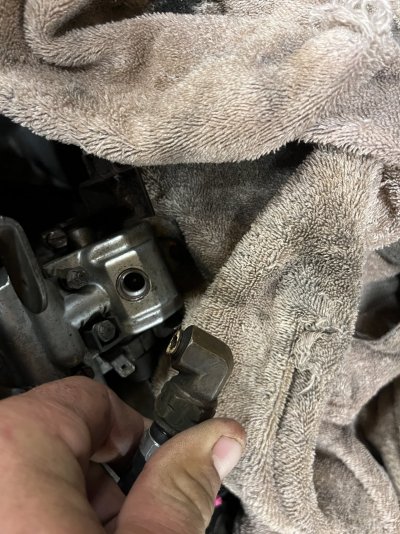

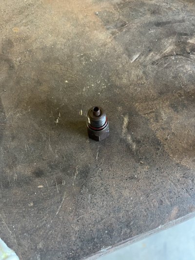

What or where can I get the correct piece to fix this?

it's a special part that has a small check valve inside to regulate housing pressure. if you have a straight through fitting, the pump will act like the cold
If you have an adjustable fuel pump you can overcome this, gaining 5cc throughout the rpm band and also cooling the pump more to boot. See TheWesPaul's thread here, halfway down the first post: DB2 Tuning Guide!
