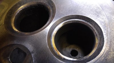

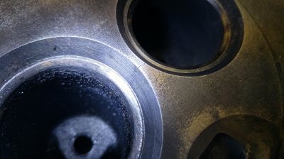

Here is the worst one, if you zoom you can see its all the way to the valve seat. You can catch a finger nail on this. I consider myself to be a very tenacious person but THIS project has been a pain in my rear from go. If it was the monster build with no time schedule or fixed budget I wouldn't care! Let me know what you think.

Eh, at most I'd have it magnifluxed to see just how bad it is.
I've put one together that was just like that on a few cylinders, because we had no other options. Boost and fuel was cranked up.
If nothing else, put it together and use it til you get another.

Those are some bad cracks if you can catch a finger nail in. Remember the exhaust seats are replaceable but the intake are not.

Don't blame you for wanting to go with the 6.9. I would start looking for a donor engine or hit the pick n pull yards for cylinder heads. Get it done right the first time and you will have the peace of mind that everything was done correctly. If you have cracked heads, I wouldn't even think about running them unless cracks were in pre-cups.
