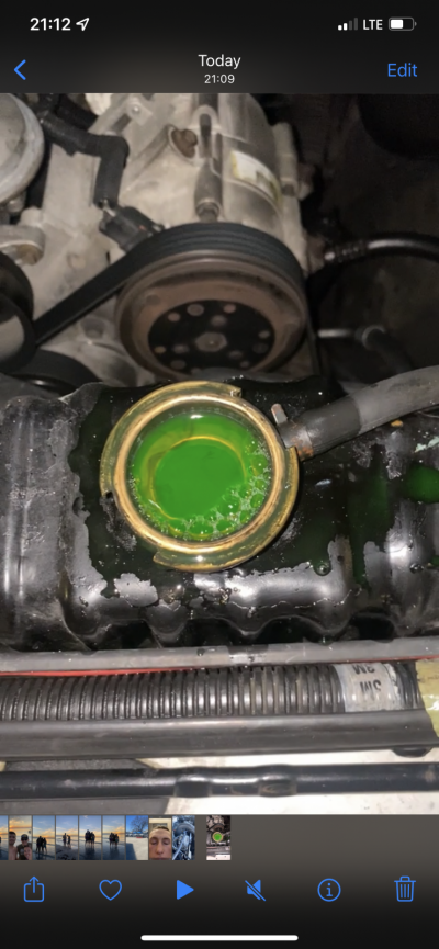

Bubble+overflow on less than a min of run time. Also notice a slight black swirl of something in the coolant.
There's your answer unfortunately. You're getting compression into your cooling system. As discussed before, I'm calling this a head gasket issue. You have two options, you could replace your head gaskets (if you replace one, I think that you should replace them both). The other thing that you can try is to loosen and retorque your head bolts in the proper sequence. Sometimes the retorque works, other times not. What happens is that (for some reason) the head bolts loosen up over time and can cause coolant and/or coolant loss. The retorque may work for you since it appears that your combustion leak is fairly slow.

Being a 7.3, it could be a cracked block as well........
Regardless, with cooling system pressure and a bunch of bubbles you're looking at a big repair.

We used to use a 4 gas anylizer to check for CO (carbon monoxide) from the coolant after removing the rad cap. Just in case there was exhuast coming from a bad head gasket. I'd change out the hose, clean the popit valve next to the thermostat, install a Motorcraft thermostat, If I found no air bubbles coming from the coolant while running it.

That rad hose looks original from Ford and the external leak is probably from the clamp on the worn out radiator hose where it connects to the cast outlet.
As for the cooling system pressurizing, I'd try the head bolt re-torque.
