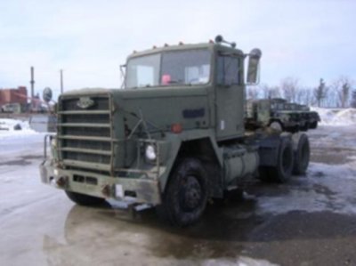

No I am not trying to get away from a fat girl. (All though they do scare me). I am trying like hell to get some good recovery equipment. I have the tow rigs now I need trailers. Once I have them, I will need some big winches to mount on them. I know very little about the big boys. I want to mount one on a 53 foot flat bed that will haul heavy trucks and equipment. I need another one to mount on a 40 foot gooseneck that will haul lighter trucks and equipment. The forty footer will be towed by my F350 and the fifty three footer by a M915. So has you can see, I need some big winches capable of dragging non running loads up on the trailer decks. Should I go hydraulic or electric? Should they have their own power source or draw from the tow vehicles’ power? What are the maintenance issues I should consider? If one breaks in the middle of a recovery what options do I have to get it running and complete the recovery? What cable and material size should I be using for these types of jobs? Where should I look at as far as buying these winches? And most importantly I need a price range. I have more questions to follow, but these are a good enough start for now.
Oh, these are my tow vehicles.
