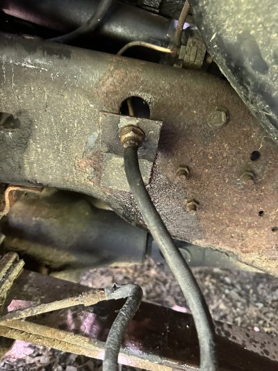

How do I remove the upper brake hose fitting from the bracket inside the wheel well, so I can put a new hose in?
Thanks for any advice

This project will go better if you have soaked the brake line and fitting with some good penetrating oil a couple of days ahead of time...
Do you have a small torch..? I have found that heating the fitting to loosen it from the hard line and then using some PB Blaster or equivalent and then CAREFULLY using a flare nut wrench to work the fitting back-and-forth until it turns free.
Once the brake line nut is loose remove the clip that holds the hose to the bracket and then pop it loose from the caliper...compare the old hose to the new one before you let the wife take control of it and get it out of the dining room....

Thank you!! I’m having trouble with getting the hose off of the bracket; where is the clip that holds it to the bracket and how do I remove it? Thanks again!

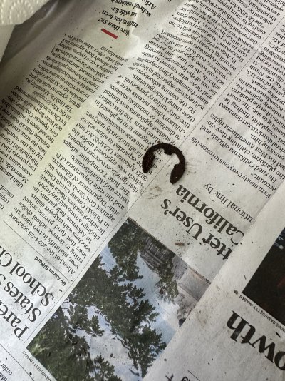

Got it - the clip sits behind the bracket and a curved pick worked well to get it off.

Yeah, the clip you have looks like the same clip that holds the rim sprocket in place on a chainsaw clutch & drum assembly. They are commonly know as the "Jesus Christ Clips" because when removing them they have a tendency to suddenly pop off with great force causing one to mutter "Jesus Christ!!" as the search begins.
