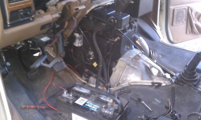

Well this may sound nuts, but the shifter won't be too terrible. 14" from bell to shifter puts it right at the back of the dog house on my 89 e350. A slight angle forward puts it at a comfortable spot

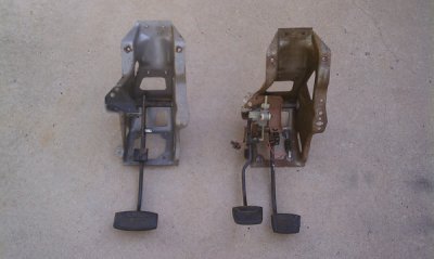

this can be an example of how you can do a cable, youd have to find a dif place to mount the bracket since this was to a t18. this is from the 71 f250 I had swap to a t18, it never gave me any issues just look around in a junk yard an see what you can come up with. the cluch petal was out 80s ford an the bracket to rod was from a dentside if I remember. the cable can be found in acuras and hondas just pulled it an put it in backwards in the sleave

Whats your brake pedal assy look like?
