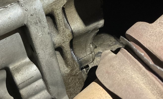

Ok it’s good to know it doesn’t sound unusual other than loud, I did find this oil leak between the bell housing and engine on the passenger side above the starter. It was bubbling when it was running. Main seal?

Could be the rear main but that usually leaks out the bottom. If this is at the top of the bell housing start by checking the valve cover gaskets. (Very common leak.). Also often the diesel or oil on the valley pan (Top of the engine.) goes to the drain hole towards the back of the block and exits out the back of the block on the passenger half of the engine, by the starter, and top of bell housing. Maybe after doing the injectors one of your return lines or return line caps is leaking diesel. But if the main is leaking a lot maybe it is being blown or slung up in the bell housing. Start by smelling it. Does it smell like oil, diesel, or ATF.

Well now I REALLY feel like a rookie. Ofcourse everyone on here was right. “Sounds normal, just loud exhaust”... the muffler wiggled itself loose, and as far as the oil leak it was just leaking from the oil pan gasket and whipping up in there just as Bart suggested. Thanks all. Still learning
