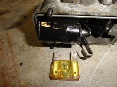

hooked a wire from battery positive to solenoid it clicked so hooked it up direct still no start. Touched wire to solenoid again no click bad solenoid I figured so I pulled it off. The solenoid that I took off of my truck is cracked so fuel was getting in it and horted something out smells very burnt that is the problem.
I took a solenoid off of my leaky IP and put it on the truck hooked up direct to battery truck started now I just have to find what shorted out.

My truck must be a little different I have a big fuse block on the drivers side fender I had a huge 20A fuse blown. In the book it also shows there are fuses for trailer lights??
Thanks to everyone it is back up and running like it should. Now I just need to find one of those huge fuses.
Picture huge so you can see the crack

Do you have a picture of this fuse block? Could be a cool mod to get rid of the stupid fuse links.
385
Those solenoids can and will crack. That's not abnormal. They will still work that way. However, if it has a short, that's another matter. It's not caused by fuel getting into it though.

The solenoid I pulled out smelled burnt so thats why I figured it shorted out due to the fuel. I put in a new fuse and solenoid and the truck runs better than ever.
