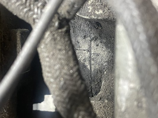

I think I found where I messed up
That’s the markings on my pump and ip gear housing there not lined up perfectly. But dummy me didn’t line up cylinder 1 to tdc. So I don’t know where my pistons where at when I took the pump off and put it back on so I don’t know if I should just leave it where it’s at now

Cheesy,
I too would suggest you look at your timing. Leaky injector return lines generally cause a hard cold start but once running and warm they usually start right up as long as it does not sit for another 4-5 hours.
Highly recommend you buy a $200 timing device and do it right.
If not in the budget then you can use the lines in your picture. Move the pump a dimes width and try to start. Repeat till it seems to start good and has plenty of power. I would go towards the passenger fender first. But if it gets worse back up towards the drivers side.
There's only one way to install an IP so it doesn't matter where your pistons, cam, etc. are at. The lines mean absolutely nothing anymore. You can line them up to get the engine running, but after that, you'll need to have it checked or at least experiment with changing it yourself.

Quick question, did you remove the pump from the timing gear cover thus only the pump itself came off.(What IDIBronco and I are assuming) Or did you pull the pump with the timing gear cover? In which case you may have a timing gear issue.

Just the pump. I never paid it much mind but I just finished fulling with it. I realized my conception on how the timing and pump worked was flawed so I was unknowingly talking out of my butt a little earlier. Just finished advancing it as you suggested and already started much easier. Will have to run it a few days to confirm but think that did it for. Navy I will see mpg go up if it’s running like it aught to. Thanks

My opinion is that you shouldn't assume that it's set right because it's starting better. You should experiment with it some more. Maybe you can fine tune it a little bit better. Then again, maybe it's where it needs to be right now. You won't know unless you do some more adjusting.
