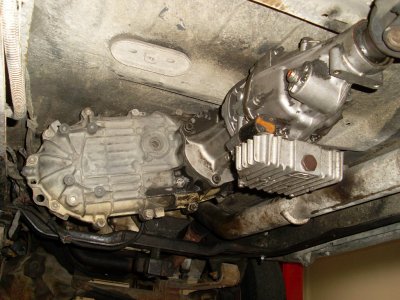

broken in two?! :confused: oh da:puke:amn how??? whyyyy??? :dunno
btw thanks for the pic! looks pretty clean :sly

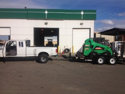

the driver is still alive and well. he has replaced the broken GV unit with another used unit. He also purchased a full set of tires for the truck just for the inconvenience he put me through. yes, he continues to borrow my equipment when he needs it.
I have yet to put another GV into the truck, due to the fact it sees extensive off-roading where having an extra potential failure point doesn't make sense. the roads often are a mix of clay soil, very loose topsoil with broken granite boulders hiding just under the surface. It's a workout for a truck let alone pulling a loaded equipment trailer to boot. he has come to his senses and has done extensive rework to the road leading into his property improving it from a heavily rutted fire trail to a graded and graveled dirt road.
this is what he was towing when this happened.

glad to here he replaced it ;Sweet thats a couple nice rigs you have right there!!! that skidloader looks bran new :sly

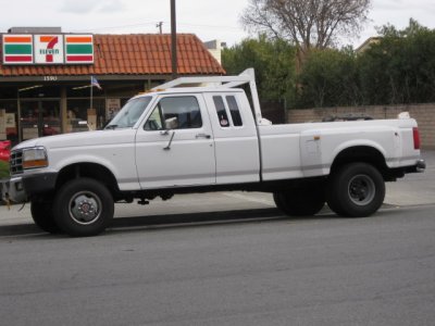

i have a rule of thumb when it comes to loaning out my stuff. If the borrower doesn't have the means to repair or replace, they don't borrow my stuff then. Truck is mime. It's a "frankenstien" of sorts. Ford should have built a SC 4x4 with a D60 front, but they didn't. I did. It gets worked hard. in fact, I need to replace the cab in the next month or so due to the right side getting taco'd really bad on a large rock. At least the frame didn't get hurt. :D

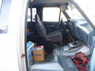

here's a couple more pics of the "Sulaco". as you can see in the interior, it's optimized for cargo hauling.

truck looks real nice, i like the interior, thats how a work truck/tool should look ;Sweet
that sad the cab looks really clean (being in the rust belt i drool over rust-less body's) did it taco pretty badly?

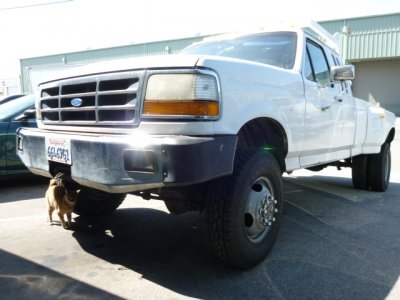

i like the front bumper ....and your kitten hahah
