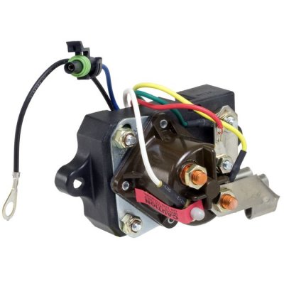

Glow plug controller HELP
OK. So I got a chance to test power to my glow plugs tonight. No even 1 volt to the glow plugs. I had my wife in the truck and turn it to the on position. Heard the glow plug controller made one click and no power to the glow plugs them self. Would this indicate a bad controller?

Bypass the controller by grounding the little terminal on the relay. If you get voltage then, it's the controller.
But relay itself could be bad. Or even the wires going to it.

So the red wire on the picture is the one I should ground out? Or the white wire?

So I ground out the relay and got nothing. So I picked up a new controller installed it and BANG we have power to the glow plugs. Im very happy to have a working glow plug system fires right up in 30 degrees now.

Very confusing thread. The original poster has the solenoid made onto the controller like the picture. Other people are talking about the older system with the relay separate on the pass side fender.
