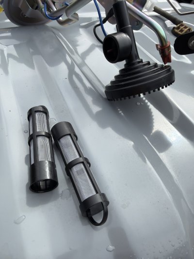

What are these two screens for that came with my new shower head? About a half inch round and 2 inches long

You might consider lengthening the fuel sending unit pickup by a few inches with 3/8" fuel line and a compression fitting. You can use a 3/8" fuel line strainer available at Summit, Jegs or Amazon.
I replaced the shower head in my side tank with one I got from Amazon that had the later PSD screens (like in your picture). The replacement shower head fell apart in about 18 months.

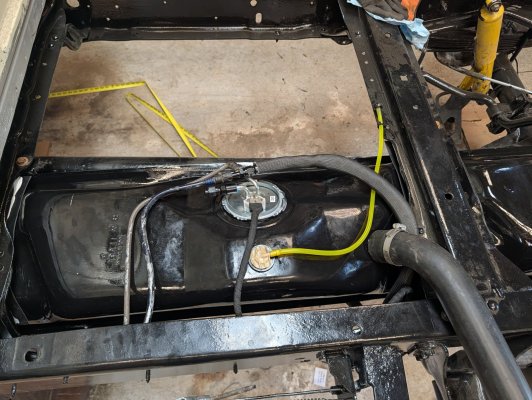

Here's the new side tank fuel sending unit I installed.

I ordered both of the sending units from Amazon. Here are the part numbers to use (for the old dual prong FSUs).
Front: FMSU-6DE
Rear: E5TFDB
The FSU above is for the side tank. Here's the rear tank FSU. Note, I've been doing this project since 1/26. Removing the tanks to service these FSUs is a PITFA! :frustrate
Definitely remove the bed if you need to service the fuel tanks. Rebuilding the antiquated Slim Jim Rotohydramatic transmission in my 64 Oldsmobile 98 was a cake walk compared to servicing these FSUs.
