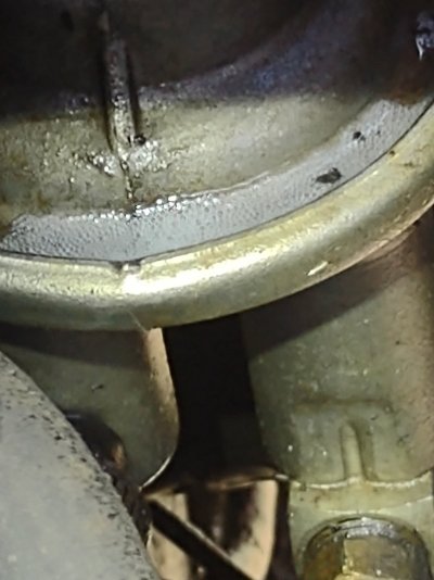

Check out this BS. This is a Carter pump I installed new 2 years ago. Time to go with a 12v pump??

If you do, research it. Rare you hear of issues other than perhaps early death with mechanical pumps. Get the wrong electric pump and you can have all sorts of issues.
If it was me I would replace with a mechanical pump again.

"If it was me I would replace with a mechanical pump again." X 2
1993 F250 7.3 IDI 278,000 miles on the 2nd mechanical lift pump. With an electric pump there are more things to go wrong.

So, is it a fact that Airtex owns Carter, and the Carter pump is no better than the Precision brand at O'Reilly's? The pump on the truck now I purchased at my local O'Reilly's 2 years ago, and has a lifetime warranty. I'd pass up the warranty to purchase a superior quality pump.

My mechanical pump was doing the same thing. It was pumping fine, but after it cooled off the housing was leaking fuel. I went with this pump. Why?
-It will help some when you happen to run out of fuel or have a minor air leak in the fuel system. You can pump fuel without turning the engine over.
-I saw a pump like this on a f350 dump truck we had. Everything else broke on that truck, but that little pump always worked. And it was mounted up high on the pass side fender.
-I am lazy. I mounted one these little pumps right on the frame rail on the pass side behind the radiator. Very near the mechanical pump. I extended the fuel line over to the pump, and then hooked it up to the fuel filter above. Very little work besides running one wire to the hot wire that feeds the brake warning vacuum switch.
This swap was very uneventful for me. Works well.

In 40 years I have NEVER had fuel leak out of the top mating surfaces of a mechanical fuel pump. I've worked on a lot of junk over this period of time. I've never been compelled to tote around a spare fuel pump. I've got 5 of these trucks, and none have them had a fuel pump fail in this way. None of them have ever had electric pumps added. I realize there's are a ridiculous number of threads on this topic. Just looking for a little concise guidance.
