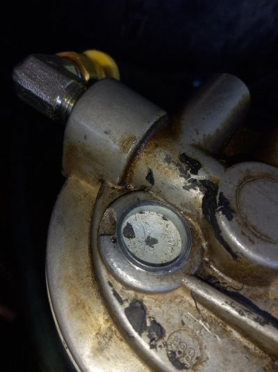

*apparently this has been my leak all along*
So i got the heater removed out of filter head but when i got it out i see a chip, couldn't see if with the heater in, all went good and i saw that and said a few words, put the doman plug 555-012 in and got it started with no bleeding of lines which was a first.
Question is there any compound one can get to possibly fix that or i need another filter head, this is the shade tree crap that ****** me off when working on stuff, their was rtv sealer on top that connector and couldn't see the chip pc..

Interesting choice to plug it, usually we tap it with a pipe thread tap and put a pipe plug in it.
Yeah i saw a couple more from the idi fb page a d said they had not had a leak issue but that chip is the achiles heal dadgum it.. im gonna attempt a jb weld and probably get on ebay for a 6.9 filter head and be done with all those plugs etc..
I can say the only place it is seeping is the chip spot .. man thinks he got so.ething fixed and 2 more pop up lol

There are fewer filter options with the 6.9 filter head. No water separator drain. If it’s not leaking now, it looks like you will probably be fine as is. I have an unmolested 7.3 filter head I can sell you if you want. Just shoot me a PM.

sorry guys hay season in full swing so i been MIA.. i was able to get that leak stopped, still having a drain back issue next step is a check valve in the supply side see if that stops it.. but i can start it with out draining the batteries..
a check valve in the return would seem counter productive since it is supposed to drain back, so we will see ..
