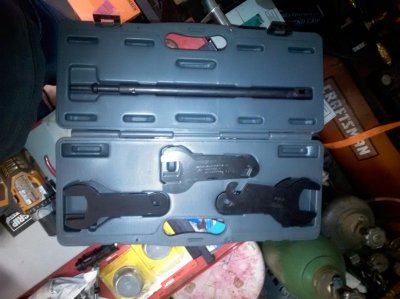

I use this tool when removing fan clutches. I have had mine for a year now and love using it.
Also if all you have is oxygen/acetylene use a rose bud tip, not a cutting tip. Unless you don't care about the old fan clutch and water pump then go to town.
