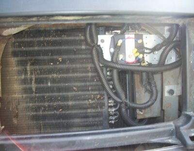

The little 30 amp cube relays are not sufficient in my opionion for a dual Taurus fan setup. I'm using contactors that are of the style you would expect to see for a starter circuit, but they have coils rated for continuous duty.

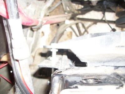

there really isn't all that much to it.its a simple follow your instincts fun easy mod.
remove your stock energy robber and once you fit the assembly down in,you'll look to see if something needs to be shaved.like the upper lip i shaved down so the fans could set closer to the rad for more clearance.the 3 corners just required pilot holes to be drilled,and then some self tappers.
i then used a bolt/ multi nut setup for the upper pass side due to it having an outset mount here.
then its just a matter of getting what you want to make them spin.
the ford windstar fans have approx 4400 cfm combined.i find they hardly need to come on,and when they do,its usually low or medium.if ever on high,it's for a very short duration.
i used the fk85 variable rate controller from here:
http://www.dccontrol.com/
i started with a normal relay based type that simply turned them on/off.the problem was the fans are just overkill on high,so i had to tone them down.
geonc's guide here was my inspiration.i just decided not to frig with the massive fan shroud because the e-fans are designed to work just fine in their own.the large stock one is so massive because the fan blade is.
if i was going to do it again,i probably would follow his advice on swapping out the larger motor for another short for easier/more room.shaving the shroud and being careful did work however as you can see.though,she's a tight fit.you could always spin the whole assembly and run it upside down.that would put the larger motor on the pass side.wouldn't hurt a thing.i decided to just see if it would fit,and it did,so i called it good.
